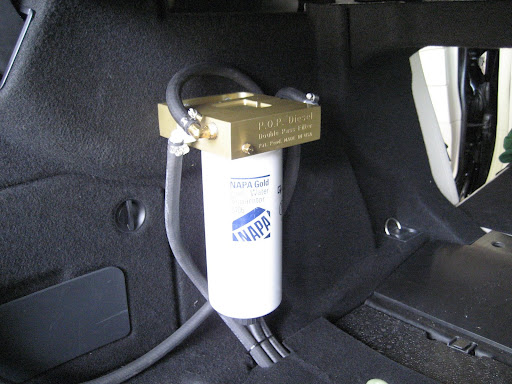

This may be a dumb question but I couldn't find an answer to it by using the search.
With the cost of most heated filters costing $250, why not put a FPHE right in front of the filter?
Omar sells them for $100 and that would save me at least $150
Or is the issue that the VO that stays in the filter between run times gets thick and you need to heat up the VO in the filter, because it appears that you just need hot VO for better viscosity running threw the filter.
thx
Registered: 17 August 2008Reply With QuoteEdit or Delete MessageReport This Post
member
Posted Hide Post
The VO in the filter needs to be heated, too, so you don't get a filter-full of cold VO injected into the engine.

Thats what I figured. Is that also why some people dont like the method of wrapping the filter with the coolant lines because they claim its not actually heating the VO inside the filter core?

I just installed a Grease Kings coolant heated filter. Really nice piece and very unusual design. It has the coolant plumbed inside the cannister that the filter goes in so it is basically wrapped around the filter itself. The greatest thing about the filter is that you can change out the element without having to re-prime the system. It has a removable top and you simply pull the element out from the top leaving the fuel in the cannister. The filter element stays in with one screw. It heats the fuel really well, so far I am impressed.
